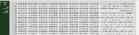

My Pro 350 complains with only a single Gotek connected, but proceeds on and boots RSX-11 from the 10M hard drive. But when try to list the directory on one of the P/OS floppy images it tells me 'invalid directory structure'. Do I really need two drives connected in order for one to work?

Ok, back in the game. Turns out to have been a flaky scan converter. VR201 is showing a display. I am still unable to either boot from a P/OS installation diskette or successfully list its directory under RT-11M. Currently I have (2) Goteks wired in as drive 0 and 1, powered from a separate supply so they are ready for access immediately. When I power up the system there are a couple of accesses to drive 0 before it puts up a system failure message with the floppy controller highlighted. Then it moves on to boot RT-11. I can access both drives (as DZ0 and DZ1), but cannot list a directory on any of the P/OS install diskettes. If I initialize the directory on a floppy image I can work with it just fine - reading and writing files. Why does the system think there's an issue with the floppy drives? Why can I neither list the directory nor boot from the install images? There must be something very basic that's amiss here, but what?
After a LOT of flailing around it appears that every single teledisk image of P/OS that's out there is bad. I converted the Venix 'xfer' diskette to HFE and it boots right up from the Gotek. Haven't been able to find a single P/OS utility/maintenence image that boots.
I have those files from avitech. Are any of them bootable? As you point out the utilities diskette is not. The system on my Pro 350 hard disk is RT-11XM which apparently expects a different directory structure and cannot read any of the P/OS image I've tried.
correct. P/OS is based on RSX-11 which uses FILES-11 disk format not RT-11 format
171-21.td0 from ftp.update.uu.se pub/professional/PRO177 appears to be the bootable P/OS install disk
I guess I should dig around and see if anyone has scanned the rest of the P/OS manuals not on bitsavers
