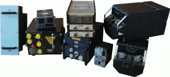

ElliottCollection.gif - Click image for larger version  Name:	ElliottCollection.gif Views:	3 Size:	159.3 KB ID:	1212971
"Relatives" of the 920M used differnet word widths (like 12 bits or 13 bits) and where
used in many applications (ship's compasses, Boeing 747 auto throttle, control of
traffic lights or industrial machinery) and I know of the autopilot computer of the
Tornado military fighter aircraft which is still in service in Germany, around 60 (!)
years after the architecture was created.
