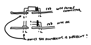

Three things.
One, You're plugging in as Drive B, so there's no chance it's going to boot unless you manually tell it to boot from Drive B on powerup, which you do with the left-shift Double-Quote ( Hold down Shift and Double Quote key simultaneously on power up before boot to swap drives ).
Two, you have two drives in there with terminators now, which may not work. Always best to get the Gotek running without any other drives connected - Just the Gotek to the Motherboard (WITH the adapter in the middle, of course)
Three, I think you may have wired a Gender Reversal into your cable. Those adapters are supposed to plug directly into the Gotek IIRC - NOT via a cable. That's possibly a major mistake because you've swapped pins 1/2 then 3/4 then 5/6 all the way along. That PCB looks like the ones I assembled, and they need a R/A Female connector, not a male, so you've swapped every pair of pins in the cable. That's on the unpowered side, so it probably won't damage anything, but it won't work either I think. It's possible your circuit board though was intended for a male connector instead of a female one - I can't see in the diagram, but you can check that Pin1 goes to Pin1, 2 to 2 etc, with a multimeter. I'm guessing they don't.
To understand point three, draw the circuit physically. IDC is a bus, so 1 to 1, and the cables are aligned side to side, but when you go through a gender reversal on the pins, the connection fom 1 to 1 goes over the top rather than from side to side, so the pins swap sides.
If you can take a picture of the adapter up close and with good light I can probably confirm for you since I have both ones I wired myself and ones I bought.
David.
p.s If you have, as suspected, wired in a gender reversal, and you want to use a short IDC cable, it should be possible to solder the pins in from the bottom of the adapter instead of the top, and that will reverse the gender again and fix the issue. A multimeter check will confim either way, as I mentioned. Especially since a gender reversal to a Gotek should short all the signal wires to ground.
Just bumped into one of my boards, and it does look the same as your board.
Here's the Pin 1 Marker... Notice it's in the place where Pin2 normally is?
I'm fairly certain now you've shorted your Floppy bus to the ground lines.
Normally you get three of those PCBs, so if you want to put in an IDC header, you can solder it in from the other side so it's Pin1 aligns with the board Pin1.
Otherwise you need a female header so the PCB cab plug straight into the back of the Gotek. A 34 x 2 DIP Female Header - Right Angle.
th-1930183978.jpgRegards
David
Must be the day for finding stuff. Pulled out a container, and there's mine.
This is how they are supposed to be used, though I'm guessing you noted that the existing cable comes up a little short to reach in that far if you keep the metal shroud.
I figure it's worth documented here in case others have the same issue in the future, which given the lack of assembly instructions provided with the PCB is highly likely.
