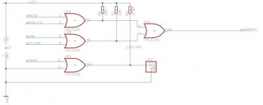

The WIKI isn't clear. Which optional parts are needed for the LED and which for slot 8 compatibility? And, which slot is slot 8?
Thanks for the feedback - I've added an image with slot-8 marked (here). The optional components (see BoM) are actually all needed for both slot-8 and the LED drive. This is because there is insufficient drive available from a CompactFlash card (some, as little as 2mA or so) for general purpose LEDs, so one of the gates in U1 is used basically as an amplifier. Others provide the slot-8 card-select line drive. For anyone interested:
