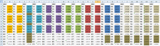

The prior table was from the IBM 5110 BASIC NX ROS.
The table below shows that the IBM 5100 BASIC NX (BCOM bin) exhibits essentially the same jump vector table at the very start (offset 0x0000):
The offsets are of course different, but the overall pattern is the same.
The offsets themselves don't mean much - but the mystery here is what Processor has these opcodes (in the "HEX" columns). The dark brown are presumably unsupported codes (like "32"hex and "CA" hex). Haven't yet deciphered what address is implementing which instruction.... But for PMC, for example, "06" is suppose to be an ADD and that does jive with the above table.

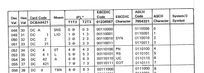

The IBM System/3 Model 10 Components Reference is listing a more extensive set of opcodes. But many of them don't actually have a mnemonic.
Does anyone know what "T1T3" or "T2T3" means in the context of System/3? It appears to refer to "tiers" (maybe tiers of punches?)
Using opcode "C8" as an example below, it seems to me that it is a variant of "BA" (card code). It can't be referenced directly from the assembler mnemonics (unless the context of use sometimes changes the tiers?). Or maybe the use of tiers is just a way to somehow speed of compilation if punch cards are involved?
Even the "mysterious" opcode 33 is similar: it appears to be some variant of card code "DC" with no associated assembler mnemonic (variant in terms of what tiers are involved).
