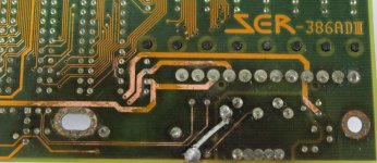

Hello people,
I got this motherboard not long ago and at first sight I could notice it was heavily damaged by a battery leak.
Thankfully it booted, but the keyboard wasn't working.
So I cleaned the leak which left some traces exposed.
At least one trace was damaged, one that goes from the keyboard DIN-5 female connector to a... is that a resistor? What is it? What are those two?
I soldered a wire to fulfill the duty of the damaged trace, and now the keyboard works!

I wonder, maybe these two black... resistors? Have been damaged and are causing this problem (I hope). I included pictures so you can please advice me what to do.

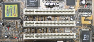

I looked at my dead motherboards and found this one that has these similar, again, resistors? (please tell me what they are) And I was wondering, could I replace them with the ones on this motherboard? Are they the same? Do they have a fixed orientation?

Maybe you still have to look for damaged traces. Cleaning it with Lemon juice and after that with Isopropyl Alcohol works for always. Sometimes you have to do it twice! Those black things looks like just ferrite filters
Hey thanks for enlightening me. Would it be OK if I replace the ferrite filters with the ones from the dead motherboard I mentioned (picture attached in my previous post)? I guess they may be related to the problem, although I'm not 100% sure of course. As you may have guessed already, my knowledge in electronics is very limited.
