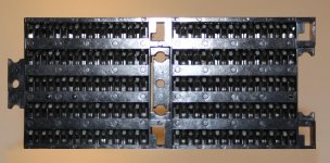

Now we're really starting from scratch. One backplane is too restrictive on the design, so I've removed all the components again and arranged to take the frame to a foundry to get a copy made. That will enable us to put the CPU and memory on separate backplanes as in the original H200 design. The H200 hardly qualified as big iron, but it's certainly small aluminium. I would have loved to follow David Gingery's example and done the work myself, there even being a few crucibles in my garage just in case, but there's just too much for me to do already.
We don't have enough sockets to fill two backplanes, but I am considering several measures which will enable the logic boards to be spread across the two. One measure may be to get additional socket cases made by a 3D printing service. Pins can be transplanted from other unsuitable edge connectors to complete the sockets. I already have a stockpile of over 700 wirewrap pins which will do. Also Marcel believes that sockets from Univac machines may be directly suitable, if there are any going spare anywhere.
It would be poetic to use sandcasting, one of the oldest known ways of making shapes, in conjunction with 3D printing, one of the newest, on this project.
RobS
Sep 28, 2012
190
Kent, England
Here's the top view. The connectors are in blocks of five. It might look like ten but each board uses two across. The pins are spaced at 0.125 inch pitch. The break-apart provision in the centre suggests that they evolved from earlier eighteen pin connectors. I think earlier boards were narrower than the H200 ones. Marcel said that the eighteen pin connectors are compatible with Univac but the gap between the pairs is a different width. For the H200 it's exactly four pins, half an inch. If the gap is the only problem then one could put Univac connectors side by side with a half inch gap and let each H200 board straddle two.
