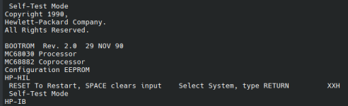

I've been looking for a HP 9000/375/380/385 and finally snagged a 375 on Ebay for cheap. It has a 50mhz 68030, 24mb ram, and a high speed serial card (98659A):
A graphics adapter is missing. I'd to install HPUX so the first order of business was to remove the second HP-IB port and design a ZuluSCSI adapter:

It looks like firmware 2.0 is needed to install from a CD, and I also want to eventually upgrade the 68030 to a 33mhz, which also requires a firmware upgrade. The ROM (M5M27C102J) in the system is stored on a one-time programmable chip, so I had to source a writable EPROM (M5M27C102JK):
This chip was easily programmed with my T48 and minipro using the firmware (v2.0) from Bitsavers:

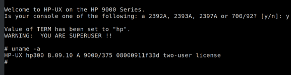

Installation is relatively easy with instructions here:
I created a 1gb image (HD1.img) and put the CD images at CD3.img. You have to switch image files halfway through the installation, and each time I tried powering off (I don't have my ZuluSCSI set up yet to change image files with a button press), I got file system corruption. I realized I could just hot swap the SD card with the new file at the "insert update CD" prompt and it worked perfectly. I'm happy to share my fresh install image file if anyone is interested.
I haven't done extensive testing, but I was told that while it is possible to use a VT100/ANSI/etc terminal emulator to do the install process, you will have a better time with a dedicated HP terminal emulator so I've been using a demo version of TTerm. I don't know of any open source alternatives.

I'm slowly working through getting patch sets installed.
Of note I couldn't get the patch instructions in the PDF guide to work, I had to use
sh PHCO_20524; update –r -s /tmp/PHCO_20524.updt PHCO_20524
