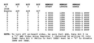

More digging, this time in the Tandy 1000 HX technical manual, turned up this table in the section talking about the proprietary chips they use on the Plus card:
Note the "ADDRESS" column: In all configurations Bank 0 starts at 0.0000h, not 4.0000h, the latter being where you'd expect RAM to start if you were backfilling a normal XT with 256k on the motherboard. This jives with the operational description in the original T1000 manuals. And if this is right, to use a lo-tech RAM card in the machine you'd want to set the switches to enable 384k (or possibly 512k, there are hints that a 768k mode may well be available. Does anyone actually have the apparently-rarer 512k version of the Plus board in their EX or HX? I'd love to see Check-It output from that) starting at 0h and the Tandy would then map the built-in 256k starting at 60000h, producing a 640k-minus-16-or-32k configuration.
If it's actually working for people who've set the switches to start at 256k then the word "map" in this gets more interesting:

Looks like this project could end up retardily simple if it didn't show 640K RAM instead of 512K or 720K, because this raises questions as to why.
Now, is the onboard RAM is being pushed to start at 7FFFFh, while the expansion RAM starts at 00000h, and then just cuts off any extra that spills over that 640K limit? Will it behave differently if slap on address decoding and start the expansion RAM at 40000h? I don't think that UMB is going to be an option for this machine, but this is more than enough to churn out a functional RAM expansion board, with plenty of room for other goodies.
While this appears to be functional, and a hell of a lot easier than we were imagining it should be, I'd still stick it behind a '245 buffer, as a matter of course, if you're going to actually use it this way.
Hah! So, yeah, that's definitely a data point.
The head scratcher that's remaining here for me is why Check-It is still showing a video page being swiped from the end of conventional RAM. I wish it was possible to read the memory mapping register for the big blue. (Tech manual says it's write only.) One of two things must be happening at this point:
A: Big Blue is getting mapped to the 512k mark, but when running in that mode BB still grabs a page from the end of RAM and masks out the A-page. (Perhaps detecting 512k base memory makes it disable half its own memory, so it becomes the same as an original T1k?)
B: It put BB at 384k, so technically the RAM is conflicting right now but it's not bothering anything.
How to figure that out...
