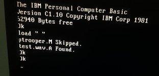

Click image for larger version  Name:	IMG_7162A.jpg Views:	0 Size:	155.8 KB ID:	1222953
And that worked too! I can tell you, for sure I didn't type this ~200 lines of BASIC myself. As expected, it didn't run - LINE 40 works, that's about it. It does an OPEN statement right after that, so the program eventually just times out ("Device Not Found" or something). So that's pretty cool too.
Only observation I have is: while loading the BASIC program, the Cassette relay clicked quite a few times - is the program saved in "chunks" of like 500 bytes? Not sure if there was any actual pause in the playback, but I could certainly hear the clicks.
Click image for larger version  Name:	IMG_7167A.jpg Views:	0 Size:	168.3 KB ID:	1222955

It looks like Wheel of Fortune is using a BASIC data file. IIRC, BASIC stops the cassette after each data block (256 bytes) is read and restarts the cassette to read the next block once an Input command accesses data in the next block. This works well with classic BASIC programs that do a lot of processing on each record before moving to the next but is quite inefficient with bulk data reads.
