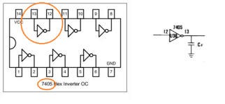

The loopback plug loops the SELECT INPUT line (pin 17) to the BUSY line (pin 11). The 'Toggle of I/P line BUSY' test toggles the SELECT INPUT line, expecting (because of the loopback wire between pins 17 and 11) to see the BUSY line toggle. We can see from the failure of the earlier 'Toggle of O/P line SELECT' test that the card's SELECT INPUT line cannot be toggled, and so that is a probable cause of the failure of the 'Toggle of I/P line BUSY' test.
So this failure is what is to be targeted.
Note that on the DB25 connector, there is a SELECT line (an input to the card) and a SELECT INPUT line (an output of the card). Confusing. I am writing of the latter. As confirmation, a look at the source code for my PARTEST shows that I am toggling bit 3 of port 3BE, which corresponds to pin 17 on the DB25 connector, SELECT INPUT.
The circuitry unique to the SELECT INPUT line is shown at [here].

Pin 17 of the parallel port connects to Vcc on every chip on the board.... I dont think thats normal ? always high ?
(with the board out of the computer)
Zero, or a few ohms (i.e. not continuity mode). And that is with the loopback plug removed.
Looking at the diagram at [here], it seems unlikely that the pull-up resistor will have gone short. Could be a problem in U37 or U38.
