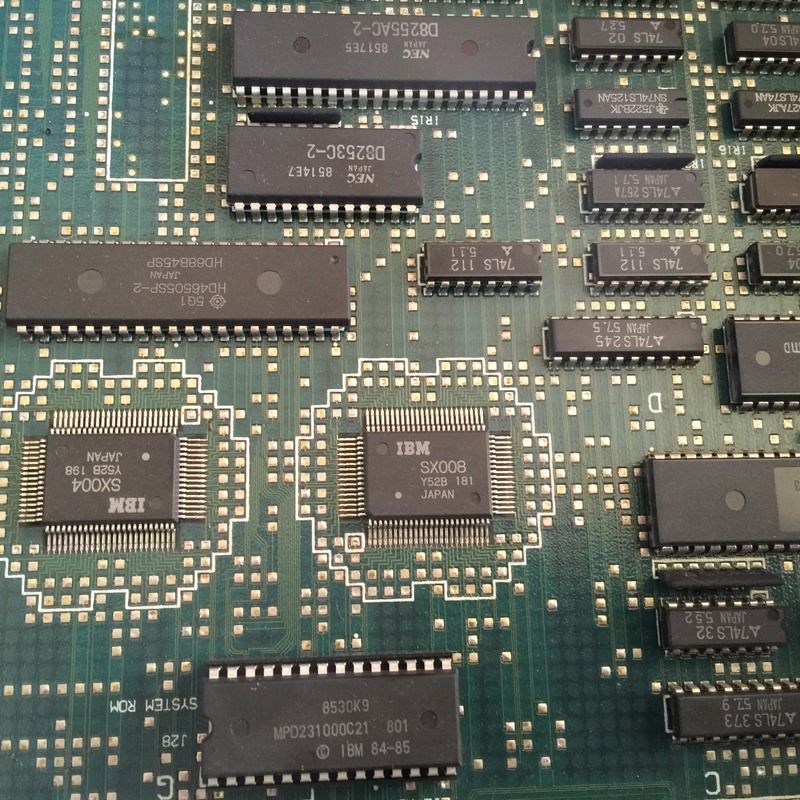

So what are the QFP chips on the board?
Curious if the system requires a patch to boot later DOSes or if the video RAM is separate from system RAM.
