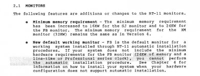

I spoke with QBUS by phone today, we were wondering what the minimum RAM requirement is for RT-11 v5. I may need add to the 16K I have installed.
Confirming one way or another about the RAM requirement might shed some light. At least in addition to any additional CPU tests.

AK6DN
Aug 23, 2010
1,013
Silicon Valley USA
From the RT11 v5.1 system release notes:
the RT11SJ monitor will run in 16KW, minimum. The documentation for v5.6 does not specify a minimum memory requirement (other than 28KW) that I can find, and for v5.6 the SJ monitor is renamed/redone as the SB monitor. So unclear at this point if v5.6 SB monitor can run in 16KW.
Earlier v4/v3/v2 RT11 systems could run the single job monitor in as little as 8KW I believe but v5 bumped the minimum to 16KW.
Probably the easiest test would be to configure a PDP-11 to the appropriate memory size in SIMH and trying to boot your test RT11 image.

I have a 64K MOS RAM board installed in slot 3 of my DD11-CF backplane. Slot 3 is a MUD slot without the NPG jumper removed. The manual says it will work in any MUD slot. It seems to work OK. I ran a memory diagnostic and loaded BASIC.
On the same backplane slot 2 is a MUD slot with the NPG jumper removed. I have had the RL11 controller installed there. The RL11 manual says the M7762 should be installed in a MUD slot with the NPG removed.
I believe I have concluded correctly where to put the MOS and RL11 controllers and that they can be together. Any dissenting opinions?
If replacing the 16K core with the 64K MOS RAM will load RT11, I would conclude that one needs more than 16K installed in the system for version 5 all else being the same.

You should be able to boot any single job monitor - RT11SJ or RT11SB in only 16KW (32KB). You may not be able build your own customized monitor or execute large complies/links without additional memory, but the basic utilities should work.
The memory and controller configuration appears acceptable.
