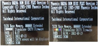

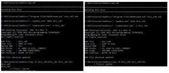

Ok, I think I've got good v87 and v94 roms both burned to 8k Eproms,
With both of these, I don't get the ROM ERROR on the 5160, however after the memory count nothing gets printed on screen except a flashing cursor, then after about 10 seconds it drops into IBM Basic.
I tried them in my 286 and I get a bit further with both roms, but it just locks up after printing the ROMSEG. Any ideas?
The original rom seems to work fine, although I still have the issue with the CHS values,
Roms and asm files attached..
Success!
There seems to be an issue in the CPU detection code that my 286 doesn't like, so just hardcoded it to the 186 code path and...
Speed seems good!
There was a second problem, which is my CF/USB adapter doesn't get on with this board and I had to switched to an SD card adapter. Even the original bios now boots with the 504mb image (CHS 1023/16/63).

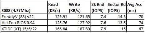

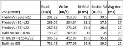

I thought some Disktest comparisons might be interesting. These were all with the same 16mb compact flash card (only this card works with the built-in IDE/BIOS on the 286).
Then same CF card but on my IBM 5160,
Strange that the BIOS is so low compared to my driver, it is supposed to be the same code, so you may not have the latest BIOS.
If the BIOS code is running from an 8-bit ROM, without shadowing etc., this could explain some difference.
