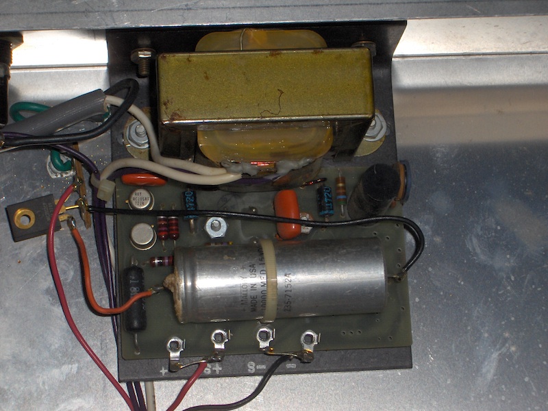

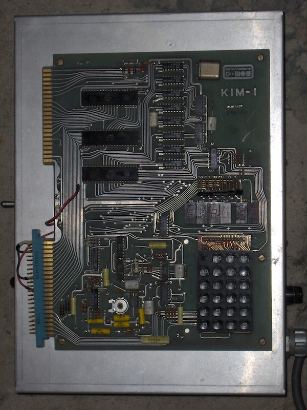

My new edge connectors arrived yesterday. Thanks for all the suggestions! Now, of course, the questions turn to exactly how to wire the new one up. The wires going to the two top-most pins (1 and A) of my existing connector have broken off, one in the past, and one when i was trying to repair the damage to the broken one. One of them is red, leading from the + and S+ terminals of the power supply under the chassis the KIM-1 is mounted to. The other is black, leading from the - and S- terminals of said power supply, and is bridged to pin K of the connector. Another red wire, connected to pin N, is from a 12-volt regulator which feeds off of the main filter capacitor of the power supply. From the diagram on page 8 of the user manual, I assume the loose red wire goes to pin A, and the loose black wire goes to pin 1. Is this correct, or am I misreading the diagram? Here are some pictures of what I'm dealing with:
(appears that the black wire was still connected to pin 1 at the time)
(I will replace the electrolytic capacitors before powering it up, of course)
Again, thanks in advance!
-Adam
There are several on line copies of the user manual. I suggest
you check them out. The answer ti your question is on page 8.
A is +5V or VCC
N is +12V or VBB
1 is Ground common or VSS
K should be tied to ground if you want to boot to on-board ROMs and other on-board resources.
I recommend putting shrink tubing over the terminals A and 1 as they are
easily shorted.
I should mention, the +12v is only needed for the cassette interface. The KIM will otherwise
run without it connected.
Dwight
Thanks for clearing that up, Dwight. It's about what I figured; I did indeed find a user manual, as I linked to above, but found the diagram and description confusing. This is the part which had me wondering: "The jumper from pin A-K to Vss (Pin A-1) is essential for system operation. If you expand your system later, this jumper will be removed and we'll tell you what to do to pin A-K." A bit confusing to name it 'A-K' when there are pins on the connector labeled A and K, and also the edge connectors themselves are labeled A and E.
Also thanks for the note on shrink tubing; whoever wired the original connector did use it, since the shorting risk is doubled on the wire wrap/chassis pin style of connector (Viking 7309) they used. I chose to buy the style of connector with solder lugs for this very reason, but may add new shrink tubing anyway. As for the cassette thing, I don't know who made the power supply in my second picture, but it has provisions for the 12V power (either factory or added-on by the user, I'm not sure which), so I'll run that line to A-N.
-Adam
