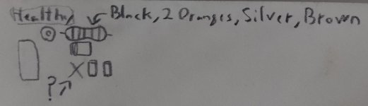

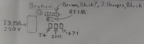

This is not specifically a computer problem, but I have found great help from this forum, when I have worked on pc power supplys, so here we go.
I have this damaged led par spotlight. The tube fuse is dead and the psu-board has all kinds of visible damage. I would like to try to repair this.
So I would need help to identify these components, especially the resistor. The red one is fuse, and the small ones are diodes?
I have (tried) written down the markings on the visibly damaged components. I also have "identical" working spotlight for comparison. But the psu board on that is different? (Yes, these are very cheap asian spotlights so there is no consistency.)

The 'healthy' resistor is 0.33 Ohms +/- 1% tolerance.
If the 'faulty' resistor had a black band in place of the silver band, this would be 33 Ohms +/- 1% tolerance.
I would expect both of them to be the same though!
You may find that the 'faulty' resistor is only scorched as a result of damage to D4. You may be able to remove it and measure the value. It will clearly need replacing anyhow.
D4 is clearly toast. I assume the RS1M came from the healthy board?
You really need to identify the circuit IDs for the other components. These will give you an idea what they are to start with.
471 is a good indication of a 470 Ohm resistor (assuming an Rn circuit ID).
200 could be a 20 Ohm resistor (but this would not be a standard part)?
T4 - no idea.
You probably need to remove the large capacitor from above the fried components to observe the circuit IDs for these components.
However, these components may have died as a result of a fault elsewhere drawing a high current.

Yes, I would guarantee the resistors are the same.
I think i got the RS1M from the faulty board somehow. The marking is same on the healthy one.
Also the 471 and 200 are same on the healthy board (maybe not same polarity), but the T4 is completely missing from the healthy board? I have no idea why is that.

There's a good chance D4, Q1, and Q2 are all shorted. There could be a shorted/leaky capacitor that overloaded the supply. You'll have to follow the power path down to see what is all blown up. Chances are the blown up resistor is just a side effect of the root cause.
