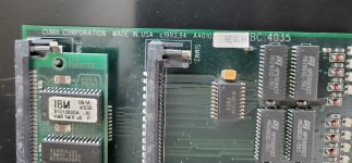

Hello,
I have a single board computer - Cubix BC 4035 A4010 and I'm looking for information on it. I have found most of a manual at...
http://www.oldcomputers.it/parts/cubix/ers/docs/sitocubix/4035-c1.htm
My current big questions are
* how to hook up video? The video out is a 14 pin connector for a ribbon cable that pushes out video + keyboard/mouse signals. The manual says they use a combo connector that breaks out to vga and ps/2 cables. So, what's the pinout? Is there any way to tell with just a multimeter (I think not)? I have used KVMs in the past that combo'd the vga+keyboard. What are the odds there is an unofficial standard?
* how to power it up? Here the manual says to use Cubix's special backplane. Can I use any ISA backplane? I have a passive ISA+PCI backplane that I've used for other SBCs. I'd like some ideas before I just plug the thing in. Preferably some facts before I plug it in. I imagine it is going to work but I'm just trying build some knowledge before blind actions.
Thanks!
A couple pics...

hey there, sorry for necroing the old thread --
i just came across this while searching for something related to these old cubix boards.
i have a fair amount of experience working with both the 4030 and the 4035 outside of a cubix ERS.
they will work in any old normal isa backplane that has +5 and -5. the 4030 doesnt like not having -5, the 4035 doesnt seem to care.
the 15 pin mux keyboard/monitor mux connector pinout should be:
1 RED
2 GROUND
3 GREEN
4 GROUND
5 BLUE
6 GROUND
7 HSYNC
8 GROUND
9 VSYNC
10 GROUND
11 KCLK
12 GROUND
13 KDATA
14 +5 (FUSED)
feel free to DM me if you want more info about these boards, they're pretty cool
