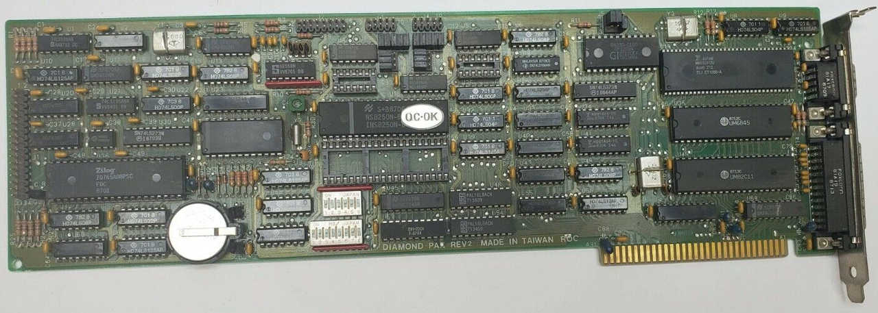

It's a full-length 8-bit ISA board, circa 1987, that just says "Diamond-Pak Rev 2, Made in Taiwan" on it. It has MDA/Hercules graphics (and/or possibly CGA?), floppy drive controller, 1 parallel, 2 serial, clock/calendar, and possibly a game port. I can find lots of info on other Diamond / DFI I/O cards, but not this one. The only thing that comes up is a few eBay listings.
I tried it in my IBM 5150. The floppy drive controller and serial ports work, and the RTC should work once I find the right driver for it (oddly it uses a CR2325 battery instead of the standard CR2032), but the parallel port isn't detected and I get no video out of the monitor output.

I have one of these cards and was looking for some info, but in the meantime i found the original software disk for it in case you need the utilities! It uses an MG-150 Hurcules graphics card. My card is branded as being sold by Jameco and having a part number JE1071. The only difference mine has it says 'Rev 4' and the previous owner loaded the additional serial port hardware (PIA and level converters which are empty sockets on your card). Quite an interesting card! Let me know if you still need the software disk.

Obviously, there has been no response to your request so far. A photo that I see online of the 'Diamond-Pak Rev 2' reveals that the real-time clock (RTC) chip on it is an MM58167. That is a common model of RTC chip on cards for the IBM PC, IBM XT, and clones. What can differ from card to card is the base I/O address that the card uses for the chip. It is a good bet that one of the RTC drivers (that is, one designed for the MM58167, or UM82C8167) at [here] will work for the RTC on your card. I suggest that you try the {PC TIMER} ones first. Then perhaps, {David_M's clock reader}. If one works, let me know so that I can add the 'Diamond-Pak Rev 2' to the web page that I pointed you to.

Oh and here's some photos of the JE1071 card I just found (the card is now gone though) this was used in a BBS, and the previous owner added the additional serial UART chips etc.
