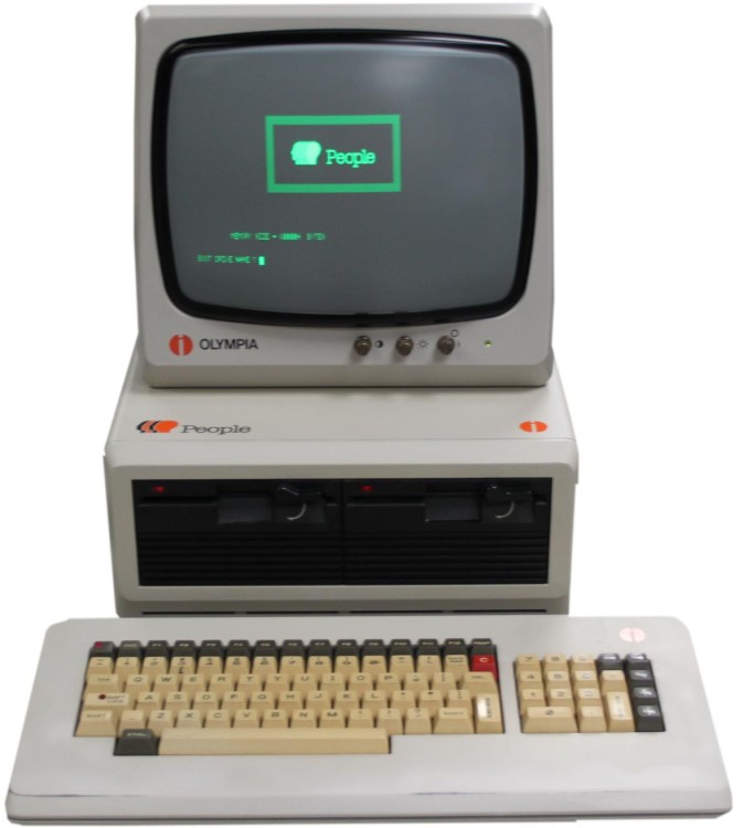

Recall that Olympia also made a standard desktop PC, called the "People":

Yes, that showed up in some of my searches.
