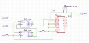

4.3. Bankselect- & refresh-circuit
To adapt the existing hardware of the Bondwell 12 to the 256 kbyte dynamic memories, the 'bank select & refresh circuit'
has been created. It has the following functions:
    generation of A7 with refresh signal / A15,
    generation of A8 / A16,
    providing a control signal for an LED to indicate the activity of the memory disk.
A7 met refresh/A15
In order to fully 'refresh' 256 kbyte of dynamic RAM, address line A7 should also be part of the refresh cycle (see Figure 4.3.1.).
Using the row / column (R / Cn) and refresh signal (/ RFR) of the Z80 microprocessor, the number of refresh cycles generated by the
processor is maintained by the counter HEF 4040. Every time 128 refresh cycles are counted, the output Q7 of the counter HEF 4040
is inverted. The LS151 switch determines on the basis of the / RFR signal whether the A7 signal to be output on output Y is normal
or refresh address. As a result, A7 has also become part of the refresh cycle.
Furthermore, the row / column signal determines whether the output signal Y of the switch LS151 contains a row address (normal or
refresh address A7) or a column address (original A15).

figure 4.3.1. generation of A7 + refresh / A15

I also have a circuit that was was used for the TRS-80 for 256 Refresh rate.
Larry
Some 256K and larger chips don't need the refresh counter if CAS/ before RAS/ mode is used--the memory IC has an internal counter. Also, you can use the REFRESH/ signal and the A6 transition to add an extra bit or two to the refresh counter. Most 1M DRAMs have this facility.
See here, for example
Later Z80 variants, like the 64180 had an 8-bit refresh counter.
Hallo Chuck,
... if CAS/ before RAS/ mode is used...
I have thought about this as well but this will also so need quite some extra hardware. That is, when using TTL. I'm thinking about using a GAL as well.
But I ran into another problem: when using the original hardware, I can only add four extra 32 KB pages. I still haven't completely figured out how Martin Moene did it with his virtual disk, in particular the use of Q0 and Q1 towards the LS174. It seems he uses Q0 and Q1 to select one of the 64 K blocks inside a 41256. But that will change the selected bank, even for just the moment to do the modification. Hmmm, when writing this I think I found it: the program is run from somewhere in the last 32 KB of the RAM as that is always present. (sorry, I'm not that good with CP/M configurations)
I was willing to write that adding just two banks of 4164s plus some OR and AND gates could do the trick. But now I have to rethink things over.
But it is not pin compatible.
The Z180/HD64180 are essentially completely signal-compatible with the Z80, as the Hi-Tech XLR8er among other speedup boards for Z80 systems showed. The '180 needs some programming to make it so, however, as the default number of wait states makes it slower than the Z80 at the same clock speed until the waits are reduced. You just need to make a socket adapter to make it a plug-compatible. The 64-pin SPDIP (0.7 inch pin spacing) package is marginally easier to adapt to the 40-pin dip over the 68-pin PLCC, but a simple adapter board shouldn't be a difficult layout and fab with 2-layer PC boards. The '180 has some significant speedups relative to the Z80, as well as some new instructions, but the commonly-used undocumented instructions that manipulate the upper or lower byte of IX/IY do not work like they do on the Z80.
Now, the circuit Larry posted is known to work ok, as the same basic circuit was used by the 80Micro 320K memory modification for the TRS-80 Model 4; I made a slight modification to that circuit for my own stab at the 320K mod, and several others made similar mods for up to 2MB of RAM (using 41256's) in TRS-80 Model 4's and 4P's.
In many Z80 designs, re-jiggering the CAS and RAS logic to support CAS before RAS refresh (which the CPU280 uses, incidentally) is far more of a challenge than just extending the refresh counter through the external logic Larry posted.
The Z180/HD64180 are essentially completely signal-compatible with the Z80, ... You just need to make a socket adapter to make it a plug-compatible.
I have thought about that idea as well. But I first thought was that the internal devices, who occupy 64 bytes of the I/O range, would give problems. I always thought that the I/O of the Bondwell occupies 256 bytes but it seems it is only 128 bytes. And as the I/O of the HD64180 is relocatable, I think it is doable. Back to the drawing board. :)
