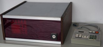

Mark 8 is running!
Mark 8 is running!
Hello Everyone,
I've got my Mark 8 up and running. (for so far)
The remote was defective. There were only three zeros in the display.
I could not put a value into the display. In the meanwhile I've got a lot
of the original documentation of this machine. Including the Radio electronics from '74.
I began to draw the schematics from the remote. While I was half way I found
an NE555 which was used as a clock generator. But no clock signal. After replacing
the NE555 I had a clock again. But the panel did still not work.
Eventually I ran into a circuit around a 7474 which seems to be broken.
After replacing this 7474 the remote came back to live :D:D:D
So now I can read and write into each memory location. Still a lot to figure out.
Defects fixed until now: NE555, 7474, mains noise filter.
