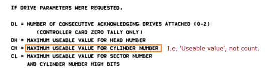

I'm working through some old MFM HDDs (backing up, erasing, etc.) but I'm noticing that the reported geometry from tools I'm using (e.g. Active@ KillDisk) are reporting one cylinder less than the stated hard drive spec. For example, I'm currently working on an IBM Type 13 20MB HDD with a Xebec fixed disk controller, which should have the CHS values of: 306 Cylinders, 8 Heads, 17 Sectors. With the tools I'm using however only 305 cylinders are being reported as thus the maximum accessible sector is 41480 (C*H*S) when the actual sectors for a 306C disk should be 41616, so I'm concerned there's data being missed out and not erased. I'm using a 486 machine, as the Xebec fixed disk controller appears incompatible with later BIOSes (it hangs on POST). On a socket 7 machine I used for another MFM drive, this issue was also present. PC-Config 9.33 reports the correct geometry.

I've found some further information:
The maximum cylinder number reported in CX is usually two less than the total cylinder count reported in the fixed disk parameter table (see INT 41h,INT 46h) because early hard disks used the last cylinder for testing purposes
This might explain why PC-Config 9.33 reports 615c if it gets the info from `int 41h` and `int 46h`. I presume then the other software is quering the drive info using `int 13h` and assuming the final cylinder is for testing.
For BIOSes which reserve the last cylinder for testing purposes, the cylinder count is automatically decremented.

In PCem with a Xebec fixed disk adapter and a Type 13 HDD, I tested crudely an `int 13h` call using DEBUG and extracted the cylinder count.
Definitely not cylinder count.
The hard disk controller supplied by IBM in the IBM 5160 is made by Xebec. IBM names it the 'IBM Fixed Disk Adapter'. IBM's technical document for the adapter is in a link at [here]. Within that document is the source code for the BIOS ROM on the adapter. At the start of the source code is:
The value returned (304) was indeed two below the drive's cylinder count.
Yes; the BIOS ROM on the IBM Fixed Disk Adapter allows for both numbering starting at 0, and allows for the last cylinder reserved for parking and diagnostics.
We can see that in the INT13H FUNCTION 8 part of the aforementioned BIOS source code:
And per [here], if an MFM controller is operating in 'dynamic' mode, then we can expect another cylinder to be unavailable to the OS.
