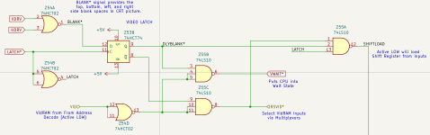

So is this (the following) the reason ? First off I don't think it is related to 32 char mode specifically, here are my thoughts
First lets go back to whats happening, memory access is being corrupted by Video Ram (I will abbreviate to VRAM) , how does this occur. The following is the buffer which buffers VRAM onto the Data bus. The important point is the controls are by VRD* and VWR*. Where do they come from.
2c2beba3-01b3-379a-7fd6-9c6d5f38edfd
These come from one of the multiplexers that selects the address/control lines (inputs) to the VRAM. You can see the VRD* and VWR* signals here, the top inputs are from the video circuitry (note how the VWR and VRD are selected as HI, basically disabling the above buffer), and the bottom input come from the CPU. Note the S line (not shown) comes from RSVID*
48254de6-6a52-819f-25e8-1ec18d7b5859
RSVID* comes from the below logic, in summary it takes two inputs, VID* - (address decoder for VRAM), and PBLANK* (is Video currently in one of the blanking intervals)
and produces 2 opposing outputs
  • PWAIT* - put the CPU into a wait state basically since the VRAM is needed by Video generation
  • RSVID* - buffer the VRAM to the CPU, turn video RAM over to CPU BUS.
Sounds logical I guess. I am guessing the JK flip flops (on the inputs) are needed to hold those signals as input for the length of time needed to process the access request.
  • LATCH - is the signal that loads the VRAM buffers (from RAM before the bits are shifted out)
  • CLOCKP - So what is CLOCKP ?
04430700-1c86-30ba-064d-3fbf2c8b1cc0
This is where it gets interesting.
If you read the The gate on the right (below) is an OR gate with negating inputs - The CLOCKP is multiplexed from one of 2 signals depending on RSVID*
  • if RSVID* is inactive - CPU doesn't have access - (bottom half) then CLOCK. This makes sense the RD / WR signals could change with any given clock pulse. Noting this is the base clock not the cpu clock. But regardless of the CPU asserts a VRAM address onto the Address bus the selection logic (above) needs to know about it.
  • If RSVID* is active - CPU does have access) - (top half) then clock with the LATCH signal ???
cf389dc5-b0af-9c34-e142-d1561b3f1c86
... OK? So what does this mean ...
This means that is CPU currently has control of VRAM the new status of VID* (VRAM address decoder) will not be clocked into the JK flip flop until the next LATCH, which happens when the raster needs to read the next VRAM byte - This could take some time ...
So after CPU has successfully done its VRAM access, The CPU A0-A9, RD* WR* signals will remain connected to VRAM, and of course this is without any address decoding! VID* is no longer asserted,... well that is until the raster needs to read the next VRAM byte. This is why the problem is only observed in 32 Character mode, its simply a case of the VRAM being exposed to the bus for longer.
Simple Solution: Get rid of CLOCKP (and the circuit above), just use CLOCK. In this case what is the purpose of the JK FLIP flop in the first place ?
Make Sense?

I don't trust my ability to static analyze a digital circuit but what you say seems to make sense. Since the bug was fixed we could verify your reasoning by seeing if the later Model 3 boards correspond to your suggested fix. Or, I suppose, any difference they have from the schematic would suggest a solution.
... I walked through it myself and, yeah, this is a genuinely baffling design. The only reason I could imagine having a clocked element in this circuit would be if they originally intended a more sophisticated snow removal strategy, like timesharing access to the video memory in-between character fetches so the CPU would spend less time in WAIT? (What I'm picturing here would be something like is an access lands during the active scanline you'd raise "wait" automatically, hold it until the current character fetch cycle has finished, switch the multiplexer to the CPU, fetch the desired character into an output latch, drop WAIT, and reset the on-shot you used to do this when the CPU RD signal goes high again. This would of course need the addition of an output latch and the one-shot logic.) Holding the buffer enabled beyond the rising edges of the CPU's read/write lines on end of the cycle that actually involved VRAM is pretty nutterbutters.

That makes sense, given the only ways you could avoid it would be pretty hardware intensive. The timing of video accesses are non-negotiable, and unless you did something really tricksy like cycle-stretching to let you "suspend" the Z80's access mid-flight you're going to have to let it finish. (Another strategy they could have used would have been to implement a state machine so the "wait" logic gets enabled a few character timing positions *before* the active area, thereby giving enough time for any in-flight access to finish before you actually need to start shoveling characters.)
It's still just really weird that they would latch the buffer open the way they did. The direction signal of that buffer could be simply connected the CPU's read or write signal (depending which direction the 74245 is facing) and the enable connected to the decoded video enable line (gated by the wait state logic, of course). I don't see any logical reason for latching it beyond the time the video address is selected by the CPU.

If you have an affected machine, you could cut a trace and test with a bodge wire.

Attached is a screen shot of simplified (untested) logic that I was planning to use in my model 1. It was based on understanding model 3 and article (first page attached) in 80 Micro

In M3 Blank* signal includes an .. OR (L8 and CHAR) term along with normal VDRV and HDRV blanking - M1 doesn't have this additional term. So on the bottom 4 lines (non graphic) the since blanking is active CPU requests to VRAM will be serviced without wait states.
However in theory, since CPU can gain access to VRAM during non-graphic character (bottom 4 scan lines), and if CPU access still active when video goes to read next character into Buffer, then will reset to 0, displaying nothing. Which is fine if the character doesn't display anything in bottom 4 scan lines however 48 out of the 256 characters will be affected.

I agree with your analysis. I couldn't see the pics either but I was able to infer the parts of the schematic from the descriptions. And yeah the scanned schematics are hard to look at. I also agree that it's not specific to 32 character mode - I'm guessing for a fast enough z80 clock it will also occur in 64 character mode. I'm guessing they wanted to synchronize the switch back to the raster circuits but it's not clear why. I think just switching to CLOCK should work - I'll look for the cleanest way to try that. I also verified the hash on the bottom 4 rows of the graphics characters. I don't know if that was a tradeoff they thought was acceptable or a flawed concept. I didn't know the problem was fixed in later M3's - I have two M3's and both have the problem.
