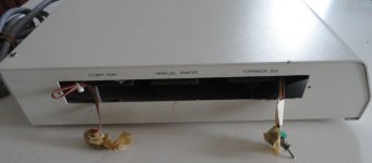

Joe, this is an interesting project and if not cost prohibitive I think many would be interested in. I have an Exp. Interface board without a case and have thought about what would work and look decent for an enclosure. The cheapest I could think of would be bent sheet metal similar to the LNW case (photos). The main problem with your PCB is that there are output/inputs on all sides. If you could rework to all on one side or use "finger" connectors and ribbon cable to route all to one side your enclosure design would be greatly simplified. There are sheet metal services online or if you have hand skills you might be able to bend the metal using a hand sheet metal brake (about $40). Look at the LNW design, it is simple and looks good.
Thanks for the ideas. Unfortunately it's not very practical to put all the connectors on one side; to do so the PCB would have to grow much larger and more expensive, and it's already pretty big and expensive.
(I don't see in your photos where the ribbon cable from the keyboard unit attaches... presumably it must be near the front--underneath, maybe?)
However you can see in the PDF that most of my connectors already have box headers as alternatives, for attaching ribbon cable that could lead to a panel-mounted connector. This would be primarily useful for the printer port and RS-232, although doing cut-outs in the metal case for the D-SUB connectors doesn't seem straightforward. And this still doesn't solve the overall problem, because there are several other connectors that somehow need to fit. And I'd really like the SD card to pop out the front of the case, since that would become the primary means of transferring files to and from a PC.
Anyway, I'm still trying to figure out what to do and the sheet metal approach is something I hadn't considered. Will give it some more thought.
Ok here's the best, most elegant and practical solution. It's not the cheapest but it will be the most sensible one.
Looking at my photo if you make a PCB the size of 1/2 the EI PCB with the ports and Power button, as well as mounting holes (marked in red) you end up with a 160mm x 195mm PCB which mounts inside the EI case using the same three original screws, and the 4 connectors are still in the original place.
The main benefits of this:
1. Those with a dead EI PCB can install this in its place, they only lose the 3 cassette ports, and the RS232 connector is relocated elsewhere.
2. At 165 x 195mm its small enough to fit in any plastic or metal enclosure out there at a reasonable cost.
In this picture the ruler shows the size of the replacement PCB, as you can see the 4 important ports all come out the original places on the EI:
