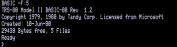

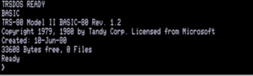

This is the basic. I noticed it displays 0 files.
I saw in manual that this is a parameter to tell BASIC the number of file buffers to reserve

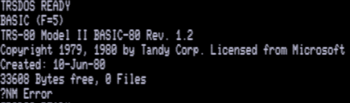

BASIC (F=5)
but that parameter didn't work. It seems it thought the parameter was a file name.

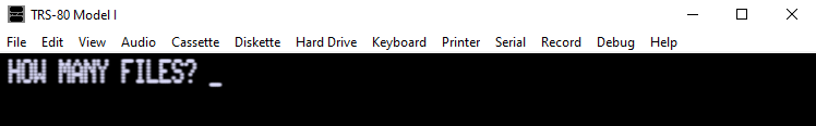

I found more books about TRS & BASIC. The Model 1 's BASIC actually prompts the user for how many file buffers to reserve. The default is 3.
Model II doesn't do that. I'll keep searching.
