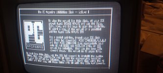

I am trying to figure out what I have to do to get this to boot up.

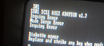

The last three pictures of screens
1). Is errors l get "301", "inquire error" & "mode sense error"

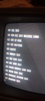

The other two pictures are screen shots of programs that start to load but stops loading or hangs loading
FYI. The "diskette error was me forgetting to put a disk in the drive"
Can this computer be booted up with a DOS 4.0 boot disk?
A keyboard error. Do you have a working XT-class keyboard attached?

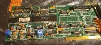

They appear under the line starting with 'ST01'.

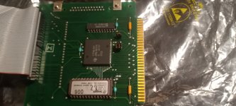

You have a Seagate ST01 SCSI card in your computer, probably the early version based on the version 1.7 BIOS ROM on it.
SCSI has an 'inquiry' command, and so the BIOS ROM on the ST01 will be what is displaying that error message.
SCSI has a 'mode sense' command, and so the BIOS ROM on the ST01 will be what is displaying that error message.
You can prove that by removing the ST01 card.

Modem7. you know your stuff, that is what I have a "Seagate ST01 SCSI card" your right it did remove my "inquire error" & "mode sense error"
now I need to dig out a good working XT-class keyboard.

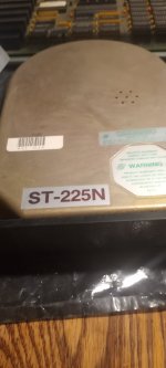

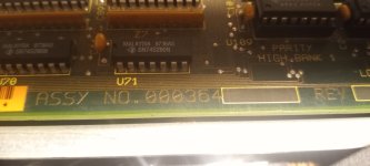

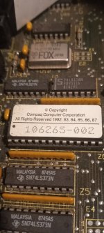

ST-225N is the SCSI version of the ST-225 (an 'MFM' drive).
According to the final page of the document at [here], the '106265-002' on the motherboard BIOS ROM (which Compaq calls the system ROM) indicates revision J of the BIOS.

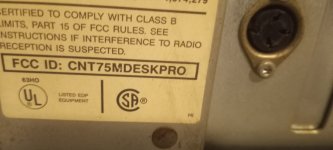

A photo at [here] shows the screws at the rear.
Wow, I did not expect that type of screw!
