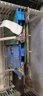

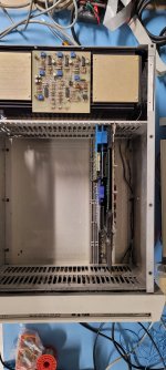

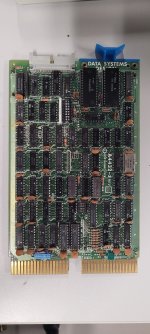

Here are some pictures...

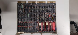

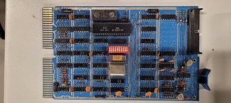

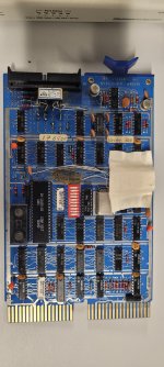

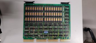

DSD floppy interface, two MDB DL11 serial port cards, a Plessey memory board, and an 11/03 CPU
Pity that the nice big box only has a four slot backplane in it
To be honest, I was very disappointed how empty this huge box was...
Now I have to figure out how to remove the power supply in order to examen and maybe recap it.
If someone has a receipe, link or pdf how to do this? Please let me know.

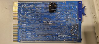

Note that one of the MDB DL11 has been modified with a relay and some other stuff. Perhaps that was intended as a RDR RUN control for a Teletype? Not sure how you'd modify any DL11-type controller for that ...
Also note that there's no controller for the Data Systems Design dual floppy drives. At least those controllers still seem to be floating around whereas the DSD drives tend to have disappeared :-<.
Interesting that the backplane is a 6-slot unit yet apparently was wired as a Qbus in the first four slots. I have a vague recollection that a third-party did sell a configuration like that; perhaps it was ACT/ABLE with one of their Unibus-to-Qbus bridges.
Well, on the upside you could install any of a number of Unibus backplanes there and host a bigger-badder CPU, although that's dependent on the capabilities of your power supply. Do you have any photos of it? I don't recall seeing any documentation for that chassis. Perhaps Al has?

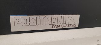

Concering the chassis itself: at first I didn't recognize what it was, because it has this sign on the front panel:
But I noticed a little piece of blue of the original patch.
No idea....
