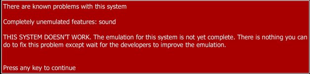

Try as I might, I'm having no success with the wy50 terminal. I suspect I'm running into another Windows build unique issue, but I would like to insure I'm using the correct approach and with the correct code base. When building, I'm simply doing this:
make SOURCES=src/mame/nabu/nabupc.cpp,src/mame/wyse/wy50.cpp REGENIE=1 -j4
There are no build errors. When executing this:
./mame -window wy50 -modem null_modem -bitb socket.127.0.0.1:5817
I see these (in order... obviously the second one is of concern, not sure if it's just because sound isn't implemented, or the whole thing is tanked):
I start the second mame instance with this:
./mame nabupc -kbd nabu_hle -hcca null_modem -bitb socket.192.168.168.16:5816 -bios 2 -option1 fdc -flop1 disks\nabupc\leo1.img -flop2 disks\nabupc\leo2.img -option3 rs232 -option3:rs232:rs232 null_modem -bitb2 socket.127.0.0.1:5817
After booting CP/M, I then do this:
DEVICE CONOUT=RS2
Nothing at all on the wy50 terminal window. I also tried using option2 for the terminal, and tried running the IA software on the local machine in case there was something wonky with the using a remote machine. No joy. Any pointers would be welcome.
DEVICE CONOUT=RS2
The second message is normal and shouldn't be a problem. For the Wyse terminal to work however you need to make sure you have reset its nvram before trying to use it, to do this hold the g key down while booting it up. If you do it correctly the screen should flash with a print out of the various characters and you should see at the top of the screen above the solid bar the letters "FDX".
