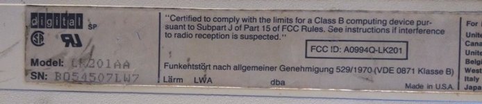

So This unit did not have a keyboard or monitor (which the keyboard connects into) So I bought a DEC LK201AA keyboard as I was under the impression this is the correct keyboard for this model.

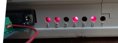

With the keyboard connected the keyboard gives a chip and all the LEDS are illuminated (and wont go out)
And this is what the LEDS on the back of the computer look like when at this state:
Anyone familiar with these units,, help would be appreciated.

From the Rainbow 100 technical manual here: http://www.bitsavers.org/pdf/dec/rainbow/EK-PC100-TM-001_Rainbow_100_Technical_Manual_May84.pdf
Appendix B-1 covers the LEDs. LEDS 1, 2, 4 and 6 lit shows a keyboard error. I'd check the wiring and make sure you don't have anything reversed.
Error 13 Keyboard - Make sure keyboard cable is plugged
in. Do not press any keys while the
computer is going through power-up
or reset. Check for any keys that may
be stuck. Make sure video cable is se-
curely plugged in. Replace keyboard
or its cable.

I have several LK201 kb's some working, some not, the ones which are stuck with all LED's on, appear not in working order?

A quick google for "LK201 all leds on" led to this old CC-talk post from 1997:
Evidently, the membrane keyboard degrades and sticks a key on, possibly shorting the matrix in an odd way, which confuses the micro-controller. The linked post details some troubleshooting steps to determine that is the cause.
Unfortunately, it appears the keyboard matrix is un-repairable.

So I followed the post and removed the kb controller board from the membrane and tried it with the computer. Now I get the chirp and all the lights flash and go out.. I still get the "MESSAGE 13 - KEYBOARD" But I believe the fault at this point is the keyboard itself.
I connected the membrane back to the KB control board and all the lights are on again.
I opened up a return on the keyboard. What a damn shame.
