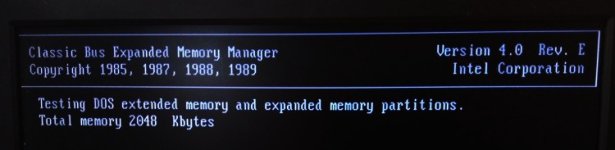

I have this here Ram card. Photos: https://photos.app.goo.gl/uobetEiwdoQ86T598
In my 5160 it will count to 640KB with the current dip switches. I cant find any information on the card. Can someone tell me what it is and where I can get some software to run the EMM/EMS portion of the card as well as dipswitch settings?

on post 6 trixter links to 3 different downloads on his ftp. I have tried all 3 download and when i run TESTAB i get the same failureIMG_20220715_144836-2 (1).png
the urrent config the 5160 has 256kb onboard and it uses part of the card to dcount to 640kb. Is the memory allocated to conv ram casuing the failure?
Notice bank 9 doesnt error. i know tbe error is erroneous because i have swapped out sveral banks i always get the same exact errors

Ok I figured some things out. I can use all the ram on the Card as Expanded/extended or I can use some as conventional and 1664KB left over is EMS memory. Thread #5 shows blocks of RAM marked bad, those are the 384KB of RAM on the card being used as Conventional Memory to boost the 5160's onboard Ram from 256KB to 640KB. If I change the dip switches I can get all 2mb to pass the test and the machine will only have 256KB of conventional RAM which would not be useful. As pictured here:
I have this, it works with Intel Aboveboard driver 4.0E
Thanks you were right about the software.
