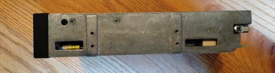

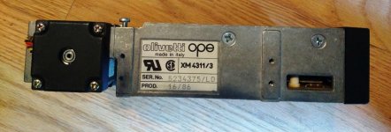

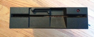

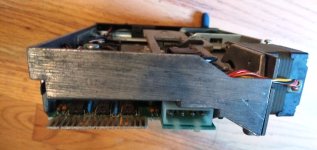

Ok I cant seem to find settings or a pdf to the Olivetti XC4311/3 Floppy Drive. If I remove the top cover it seems all the settings are configured via one jumper block but of course its not labeled.
There are not posts on this forum about the Olivetti xm4311/3 Floppy drive. Does anyone in Europe have info on this drive? Is it a pipe dream wanting to use it on an IBM PC?
I couldn’t find anything either. Do you think it’s possible that it’s actually made by another company and that it’s been rebranded? Is it a drive for an M24? If so the AT&T manual lists a few different floppy drives near the end. Maybe it’s one of those? I don’t know. https://bitsavers.org/pdf/att/6300/
That's not rebranded, that's original OPE drive for M21/M24. It should be well documented in the Olivetti pocket service guide for floppy drives. (I can't have a look in it to verify, I am not at home.)
Ill have to find and look at the service guide.
Not sure where I got this drive. I do own a Xerox 6060 but this did not come with it.
Olivetti used different drives for M21/M24, specially later M24 and 6300 and 606x came with other drives than this. (Toshiba/TEAC/Panasonic)
Most importantly. Have you known anyone to get one of these drives working on a PC that was not made by olivetti?
