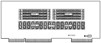

Here is the diagram.
That's not a diagram, it's just a reference telling you where the slots and sockets are for memory.
The real card is going to have a whole lot more support logic on it. You can't just wire up memory chips directly to the ISA and system bus and expect them to work. What's really going to complicate things are the cache chips, because CPU cache needs a bunch of logic to determine what to hold in the cache, when to retrieve data from the cache, when to flush the cache and a lookup table in TAG memory.
It wouldn't be impossible to lay out a memory card and have it fabricated, but it would involve quite a bit of reverse engineering to know the pinout of the special connector and how the system uses it. You could likely use another similar memory card from the time to get clues on how to build yours, but again, it'd require a lot of extensive and deep electronics knowledge.

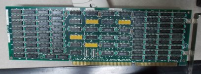

The isa connector is probably only there for power.
The logic on the motherboard handles the cache/dram arbitration. What's on the memory card is
address decoding / multiplexing and timing for the drams. It would probably be possible to use
modern big srams and reduce the component complexity even more
Here is what an Intel 2meg card looks like
Yes , I was just providing it for Al Kassow. I have experience with adding memory for 68HC11's, but that feels simple compared to this.
This was my guess as well. The 32 bit bus is probably the proprietary connector, on the motherboard it appears to be a 16bit ISA connector in reverse. My real hope is that i could use a different 32 bit card and rig it up. I guess I should start with the datasheet for the 80386dx?
