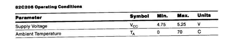

According to the datasheet, the battery input should be 6V, not 4.5V. The specified VCC minimum voltage at the 82C206 input is 4.75V, plus there is at least one, maybe two, diode forward voltage drop from the battery input if the motherboard follows the recommended VCC power circuit.
Inadequate battery voltage does appear to be the problem cause here.

And with the motherboard powered off, report the DC voltage of the 82C206's Vcc pin. That may help us.

Maybe the fact that the 4.5V battery is resulting in some voltage on the 82C206's Vcc pin, is the reason.
OK, made up a 6v adapter, and left it overnight without power. Started up today perfectly!!!! Wonderful!
Thanks everyone for the help.
