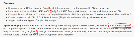

Next - this is working only with the "hard disk drive" slot 7. None of the images load in the Floppy Disk Drive (which in the real/physical setup, ya'll are saying those are always and only 140KB disks-- at least as far as since I am using "stock" Apple floppy controller card, as far as I know).
So - there's no way to make this work with the stock 140KB disks right? First there is no physical room on the media, or any format that drive might support. Then second, there is no way to detect when the system has prompted to flip the disk, and interpret that to "automatically flip the disk" ?
So for hard disk option (something I never experienced on early Apple's): is there some Slot7 card I need to seek, with a cabling that might be compatible with the FloppyEmu (i.e. even though called "floppy"Emu, it has a mode to support hard disk images).

As for real hardware. The floppy emu site states that a IIe with a Yellowstone controller card will allow the floppyemu to read 800k images. It also has a range of image types.
