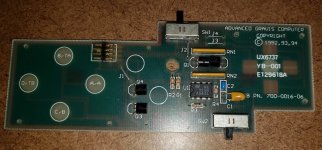

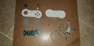

Back around 2007, I found the gamepad in (seemingly) perfect condition in my retrocomputing collection. I tried using it with Descent (just to see if I could play it easier), but that didn't work. One of the buttons would not respond. I figured there was a cold joint in the solder points on the board (not a bad assumption given how SOME of these retrocomputing items were previously constructed.) But it didn't fix anything.
I put it away for a long while. In 2017, I got a new retro computer, and I had a Sound Blaster on-hand to test its capabilities. I got the Gravis Gamepad out, and tried it again. As I was testing it, I realized it WAS in fully-working condition, but only when the cable was pulled straight. The best assumption I could make was that there was a break in the wire for the previously-mentioned button. It doesn't help that the cable is bent rather strangely in the controller's case. I took it apart, hoping that I could cut the cable behind the break, and reassemble a new connector with crimping tools.
I wasn't able to. (My skill wasn't the problem. It was the crimping tools, and the wiring. A few manufacturers I've tried don't make it crimp precisely enough, or it crimps it too hard, severing the connection. Plus, the wiring inside the cable is VERY frail and thin.)
