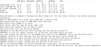

Made this awhile back and posted it to VOGONS, though it garnered no responses. Just found it again. Nothing hugely detailed, just some scored from Phil's Benchmarking pack. Options 2, 4, 6, B and C were used.
Seems to be about what I would expect - Didn’t AMD basically market the 586-133 as a Pentium 75 equivalent?
Thanks for the response. Glad to know someone appreciates that. Supposedly they're supposed to be a Pentium 75 equivelent, at leats as integer performance is concerned. (They are marked P75+). I'm mildly curious how a Pentium 75 actually stacks up against a Pentium 66, as the former runs a 1.5 times a 50Mhz Bus while the latter runs at a full 66Mhz.
Also, there is an error in that chart. Both boards were run with 32MB total, and were tested separately, with the same two sticks of 16MB ram.

If the Pentium was "just" a fast 486, nobody would have bought them because the 486 arch went all the way up to 200 MHz. This wasn't the case at all though, the Pentium is a completely different design that was much more efficient at a lower clock speed and the chart in the OP shows.
