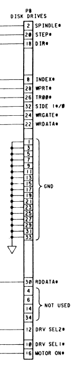

Thanks for the info. The Kryoflux's cost isn't prohibitive. I have hundreds of floppies to go through, so I'd rather not risk shipping them and then pay for hours of someone else's time. I have a "standard" 1.2mb 5.25" drive (Mitsumi D509V2) that I could connect to a flux reader as a standalone unit. I'm guessing I could use that to reliably read and archive the Osborne Executive floppies, but would I also be able to use that drive to write floppies for the Executive? I don't have my head wrapped around everything yet (so many drive specs and file formats), but I've read that 40 track drives like my Osbornes' can't reliably read disks written by an 80 track drive. As for properly powering the Osborne floppy drives when used with a flux reader, could I not just leave them connected to the Osborne's power supply but connect them to the flux reader's data cable?
You have to remember that you are now dealing with Pins 11, 13, 15, and 17 with +12VDC, and Pins 21, 23, and 25 with +5VDC, which are
typically GND for the IBM and Shugart Interfaces.

Just a quick note that the Osborne Executive does use the Shugart standard floppy interface which doesn't have power on the lines, unlike the Osborne 1 which does.
