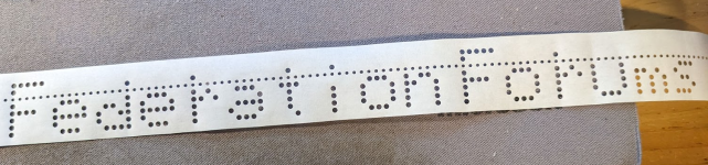

One of my projects last winter winter was to restore a standalone paper tape punch I had sitting in my basement for too long. I repaired a dead solenoid, learned a *lot* about how the mechanism worked (genius!) and made a quantity of improvements.
  • switched from a constantly running AC motor to a stepper so it would run only when actually punching
  • add the capability to automatically add a direction arrow to the beginning of the tape
  • ability to switch between text and binary for the punching operation
  • USB link
  • replaced (but retained) the original driver board with a microcontroller driven ULN2003 based design. It's notable that the original board had not 1 but 3 555's :-)
  • add a large number of dim blinking red LEDS so it retained some period authenticity
I'm embarrassed to say that I don't have any good pictures of the machine, but below is a picture of the mechanism in mid-repair (first thing you'll notice is that at least one bit is missing)
I was going to make a little side hustle out of it but I ran into the issue of not being able to source tape. I have a couple of rolls of the original yellow stuff but they might be the only yellow tape left on the planet. And this might be one of few standalone punch machines in the US as well.
Which is why I'd like to offer here to punch paper tapes for your projects. The only catch is that the tape will be modified cash register tape rather than original.
The Request: If any of you have sources or ideas for finding or manufacturing blank paper tape (aside from the onsie stuff you can get on eBay) I would love your help. If we as a group want to commission a boutique run of rolls (which I likely can't afford individually) I would love to be involved.
So please let me know if you need tape punched. I've also attached an example of the font print.

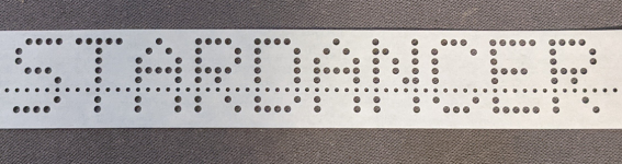

I can also send out text-based tapes, I did this one for a friend,

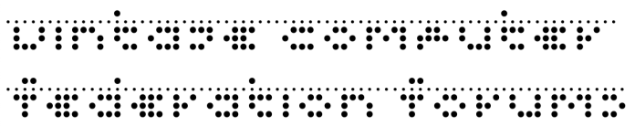

Since you're into the typographic aspect of this tech also (I am too), thought I'd share this really fun Baudot tape derived font ("baudotpunch") that I came across. It's included as a freebie with this more substantial Trod typeface:
Most charmingly, the type specimens are included as actual disk images for Apple II and classic Mac.
(It renders the lowercase characters as above, but for caps and digits it renders one line of actual Baudot punch dots. Neat!)

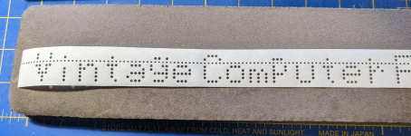

That's right, I forgot all about that - I had to create my own font :) I couldn't find anything on the web that was applicable so I printed up a whole bunch of 5x7 graph's in a word doc and then went at each letter with a sharpie until I got it looking about right. Then I ran it past my friend Kevin, who's much more of an alpha-nerd than I am, and he made a bunch of corrections.
It's interesting the above font is upside-down as compared with mine. I'm pretty sure I'm right - I used wikipedia pictures and some other references to make sure I got it right. It should be 2 bits under the feed punch and 5 bits above.
Just couldn't help myself :)
It looks better when it's all caps.
Also, I TAKE BACK everything I said about the above font being upside down. Clearly the tape I showed earlier was a "pre-production (!)" tape and it was backwards, since the one I just printed has the feed holes nearest the top.
Cool! Mixed case (especially with descenders) is just so hard to do nicely in a small fixed grid. Some Motorola char gen chips used 7x9 characters but had a shifted mode that "dropped" the glyphs with descenders a couple lines down during the output dot scan. No such cheating on punch tape! I feel like you have one extra row of dots available if you want to use it at the top there, no?
There were 70s punched tapes that had (all-caps) title text at the head of them (I've seen examples of Pittman's Tiny BASIC like that)-- I don't know if that was just one off stuff by whoever was making the tape or whether some of the equipment (33ASR) had a way of doing it automatically?
That's a really good question - all the printable characters at the time were in the lower 7 bits (this machine was manufactured in 1975), so while the machine does have an 8th bit I don't think it was used except maybe for parity?. And I didn't code parity. So both text and binary modes only takes advantage of the lower 7 bits (since the binary is just a character in an interpreted language like BASIC). I guess I could change that, but then I'd have to create a whole new font.
but then on the other hand if you were punching actual binary on it like a boot loader it would have to use that 8th bit. Now I need to go see how binary mode actually responds when I send it >127.
