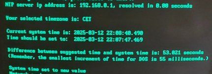

Today I upgraded my M19 with a real time Clock (RTC).
Install was painless after I was pointed to the proper driver to be included in the CONFIG.SYS file. The card is so small, it almost seems to be designed with the M19 in mind.
Hi Jan,
I did the same but since I also use NTP when booting I found out that the RTC is not very accurate. Does yours behave the same?
The picture is taken after not having booted it up for about a week.
