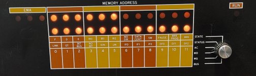

I need to replace some of the lamps on my PDP-8/E front panel. The minimum order quantity is 100 and that costs $90 plus shipping.

I was able to find a suitable lamp for $0.60 each in quantaties of 10 or more. I purchased 100. I have about 50 I can sell, at cost plus shipping. Please contact me directly if you are interested.
One person already contacted me but I lost the return email.
What I found is an Advanced Micro Lite AML 7367 which is the same as the JKL-7367.
I bought them from Specialty Bulb Co, Inc in New York (www.bulbspecialists.com)
The bulbs came from Advanced Micro Lites in IL. (https://www.advmicrolites.com/incandescent/)
Old and new bulbs compared
Click image for larger version  Name:	BulbComparison.jpg Views:	0 Size:	211.9 KB ID:	1226202
Old bulb on the left new bulb on the right. The old bulb is a tiny bit brighter.

Front panel with all new lights:

I found that new bulbs have smaller diameter leads than the originals. I had to bend the leads to get them to fit tightly in the sockets.
I did not find that problem with these bulbs but I might just not have noticed.
I will agree that they don't fit quite as tightly at the PL10160
