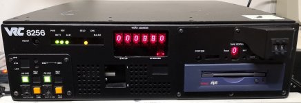

Only write it out when the server closes or you ask it to. This will help protect the micro SD card.
Sounds good to me! That is also the way how my VRC 8256 RK05 emulator works. In this way you can do whatever you want without messing up your original image. But don't forget to save it if you want to keep your modifications. I have lost my work several times... 😤
