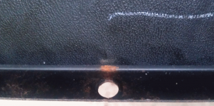

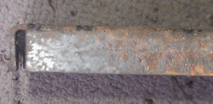

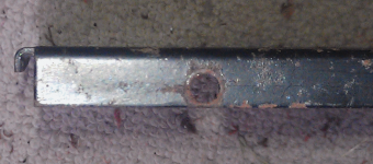

The top and bottom covers are not really a problem to make, but I'm missing details. I would like to have some info about how the end of the metal sheets are made at the front side.
I think the top cover is bended at 90 degrees. Can anyone confirm this? Of have a picture?
And I think the bottom cover is folded back. Can anyone confirm this? Of have a picture?

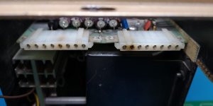

The power connectors from the cable harness are G772 boards. I only have a G772B, but this board seems to be a bit higher and has a bit different layout.
This is my G772B
G772 board which I found on the web.
Can anyone give a good picture from the front and the back and the size of the G772 board? Then I can make a few replica's.

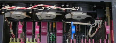

Another thing which got my attention are these capacitor boards. Does anyone have pictures and/or a model name of them? They don't seem to be in all slots and also not in all machines. To me it seems that these are for the 5V only, because that is the only connected power in the not connected slot.

I have a FOX 2 aka rebadged PDP-11/15. The box, power supply and most of the KC11 CPU is similar to the 11/20's KA11.
I can measure up the box lid and draw it up in CAD for you. You are correct the edge is folded 90 degrees. I can remove the bottom panel and take a look at it too.
I think also the power paddle boards are the ones you are after so I can take a few pics.

Regarding "Another thing which got my attention are these capacitor boards. Does anyone have pictures and/or a model name of them?"
That is a G8000 +8V Filter Network.
They are used in the DP11-A Synchronous Line Interface option. Which is a four slot system unit.
More information here http://www.bitsavers.org/www.comput... DP11-A Synchronous Line Interface Manual.pdf
The DP11-A Synchronous Line Interface option requires +ve and -ve voltages for the modem EIA interface and the PDP11/20 power supply does not provide sufficient +ve voltage for the EIA drivers.
I believe the G8000 module generates +8V from the line time clock signal!
The DP11 is the only Unibus option that I am aware of, that requires the G8000 module.
There should be one tiny diode on it, as well as the caps.

The 4 slot backplane with the G8000 card will be a DP11-A backplane. It can’t be used for any other purpose.
Did you remove the G8000 card and see the single small diode?
I don’t know what the small card is, in slot A12 of the KA11 processor backplane.
The orientation of the capacitors appears to be different to the G8000 card.
The KA11 schematics suggest that that slot is not used?
Can you check the wire wrap pins for slot A12 and tell me if there are any wire wraps there?
Any power in slot A12? Black = Ground, Red = +5V, Blue = -15V, Orange = +8V, Green = -20V
If there are no wire wraps then the module has no function. It’s just being parked there?
Can you remove the card and attach a photo?
Is there any identification marks on the small card?

I measured a G772B in the FOX 2. I tried to take out the one going into the memory but it won't come out without removing the thumbscrews and lifting that module up a bit. It's a bit awkward to do that at the moment but I'll get to it sometime.
The finger width is what I calculated after subtracting two thicknesses of the black insulation tape (0.17mm thick) but it probably won't matter much.

Thanks, so it is the G772B version which is used in the 11/20. I've drawn that PCB already but at a later moment I thought the B version was wrong model. I thought the original 11/20 was a G772 and in other/later machines a G772B was used. Good to know, thanks! So I can order these boards anyway :D

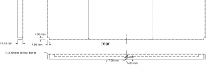

Here is the top cover panel for the BA11-C (mine is the S subvariant) for the PDP-11/15 and PDP-11/20. The overall panel, then closeup of the front edge measurements and rear edge measurements.
All folds including the front short edge are 7/64" radius. The panel is 16 Gauge (1.6mm) steel and like all things DEC is quite weighty. I reckon it would probably be ok folded up from aluminium sheet too.
