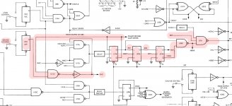

But before killing Q42 again I decided to look more closely the functioning of the BOT detection as well as the deactivation system of the Rewind Ramp Generator.
In order to better understand the BOT detection process during the rewind, I extracted some information from the documentation. It looks like this (unless I'm mistaken):
DURING REWIND
1. BOT TAB DETECTED
2. U17A is set.
3. U18D Second single shot is triggered
4. U23A The Q output of flip-flop RW3 & NRW3 goes low
5. U38A & U38C are disabled, NRWR & NRWRD go high
6. it deactivates U51 (K2 relay driver)
7. and triggers the 0.5s single-shot U31, Q9 and associated circuitry
8. Q50, Q51, Q41, Q42 turn on for the duration of the on-sate condition of the single shot, this raise the reel servo amplifier current limits for the large deceleration required to bring the reels to a rapid halt.
9. Rewind ramp generator is disabled
By analyzing this I start to think that a relation is possible between the failure of the "taking into account of the BOT" during the Rewind and the destruction of the power transistors on the heat sink.
If U51 does not deactivate K2, the machine continues its rewind. Meanwhile, U31 single shot send the juice via Q50, Q51 to Q41, Q42, to stop the rewind. In that situation the reverse (Q43) and forward (Q42) transistors should be activated simultaneously during 1 or 2s until the tape is fully unwound.
It could also be something other than U51, this sentence jumped out at me:
"Turn on for the duration of the on-sate condition of the single shot"
What if U31 didn't do the job (no shot ? continuous shot?) This would explain that the transistors were not necessarily always destroyed when the BOT is detected during a rewind but also during normal fast successive rewind / forward operations.
Finally it may be Q50 and/or Q51 no longer work, the rewind does not stop because the power is too weak to counter the inertia of the reels but it still tries to forward while the rewind is launched at full speed ... But would that justify a breakdown of Q42? Not sure ...
How to proceed ? To limit the breadown of my power transistor maybe start to desolder and test Q50 and Q51. If they are OK, observe in full rewind if K2 is triggered when the BOT passes in front of the sensor, that would directly confirm that U38A and U51 are working or not. If K2 is triggered, try to find the culprit at the level of U31, Q9 and associated circuits. Now for this a small problem : no Q9 in the schematics and diagram, it's just mentioned in the text of the manual (Inconsistencies in documentation due to multiple board revisions?)

LAST NEWS :
- With a lot of attention I observed the relay K2 during a rewind, no reaction when the BOT passes in front of the sensor.
- I managed to start a bootable tape in a cold start mode on my DCC-116 (Clone of DG Nova 1200), after the complete loading of the OS, the computer initiates an automatic rewind (by software or EOT), this was enough to instantly burn out the transistor used for the Take Up Reel forward, namely good old fellow Q42.
So about the death of Q42, it's not just a question of the passage of the BOT in front of the sensor during the rewind, but of the simple fact of initiating a rewind. Or maybe more specifically: to initiate a rewind during a forward, the transition between forward and rewind, a short time when Q42 and Q43 are maybe used at the same time.
I also want to add that the tape drive did a lot of low speed forward / rewind during the loading which it did not do before the failure. With most magnetic tapes, after a certain number of retries, the computer or the Pertec simply stops reading and stops the loading process.
I wonder about the possible imprecision of the transistors which control those dedicated to power.
Also I think I will replace without going into detail:
Q39, Q40, Q45, Q46, as well as Q50 and Q51.
On the Heatsink the only ones that I haven't replaced yet are:
Q57 (-10v) and Q32, Q33 (capstan servo amplifier reverse and forward), I think I will also replace them.
But what is the common point between the absence of reaction of K2 during a rewind, the death of Q42 because of a rewind during a forward, and the imprecision during the reading of the data?
That's the question
