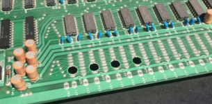

Thanks, Dave. Do you happen to have any pics of a drilled board? So I take it that some boards had unpopulated IC patterns that CBM destroyed to prevent their use? Can't really blame them, that was an extremely competitive market in those days.

The stock RAM is almost always soldered in Dynamic boards. How difficult going to 32k will be depends a lot on what the RAM config in there is. It’s *probably* one bank of 16kbit (4116) drams, but the service manual has jumper pad configs documented for an alternative of two banks of 4108s. (I would guess the latter is rare and they only used 4108s on the 8k sku, but Commodore is always unpredictable.) If it’s one bank of 16k and they didn’t sabotage the board you should be able to turn it into a 4032 just by adding the missing parts and changing the solder jumpers.
I'm pretty sure I posted a picture of my drilled board at some point, but it doesn't look like the new forum software has the "gallery of attachments you've posted" feature of the old software (?) so I can't find it. But trust me, it'll be obvious if your board is drilled. There will be a couple holes about the diameter of a pencil obliterating some traces and IC pads in the area of the board where the unpopulated memory chip footprints live. If you have unpopulated footprints *without* big obvious holes then fully populating the board may be a legit option.
Unless it's a very early 4016 with the 9" screen, it's likely a universal board and AFAIK, those were never drilled out since that would damage other things.
The banks are 2x16K so there's probably one bank populated and the other empty making it simple to add the missing ram chips.

Here's a photo of a board that has been drilled out and upgraded anyway.
Another alternative would be to do a piggyback job over the other bank, but that's a bit ugly.
The exact location of the holes seems to vary between these drilled boards. I want to say that on the drilled one I have there's like two holes in the actual memory chip area and a third hole off to the side severing some of the traces going to the bank at large, but I guess without getting the thing off a high shelf and looking at it again I can't confirm that fuzzy memory.
Here's a better pic of a drilled out board.
Thanks, that is a better pic, or at least a more-drilled board.
As noted above, it really doesnt seem too challenging to handwire around the drillings. If my board has been so abused, that's very likely the route I will take. Don't think I have any Kynar, though.. but the 28ga stuff from old Bell System 25-pair cable should be fine.
ETA: Frustration! There aren't any unpopulated patterns on the board, drilled or not. So it looks like I'm limited to a piggyback hack (ugly, I agree) unless I want to buy a 3rd party upgrade board. So that kinda sucks.. and is likely why I've never done anything with it previously.
OK, that confirms it's an early 40xx with a 2001-N mainboard.
There are jumpers on the board to set what type of RAM chips are being used and how many.
You can have two rows of 16K or two rows of 8K. I guess you got two rows of 8K.
