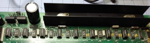

One more pic of the machine's internals after an appointment with Dr. Dyson
Plan now is to u/g the RAM to 32K and leave it at that. I will still order a small batch of the 40/80 Switcher boards anyway, and offer them for sale here & elsewhere, keeping one for myself if I change my mind later

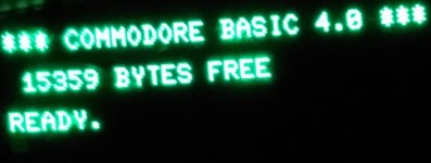

Well THAT didn't work..
I'm not aware if the 15359 Bytes figure is correct for a 16K machine, but it is about half of the 32768 bytes that I'd roughly expect from a 32K machine.
Earlier in this thread I was told that no jumper changes are necessary.. that the new RAM would be autodetected.. so I've done nothing except install the new sockets & chips as in the photo.
ETA: What should the byte count be, 31743?
Ideas?
WimWalther
Jan 12, 2019
435
St. Paul, MN
@Colin
Thanks, that agrees with what I'm finding.
@all ,
So I wrote a little BASIC to poke & peek the new RAM range (16384-32767) with 0, 1 & 255, and the PEEKs return garbage. It's as if the new RAM isn't even present.
I suppose it's worth trying each bit individually, which will be next. The keyboard is in desperate need of cleaning, which makes typing no fun at all.. should probably take care of that as well. But the RAM thing is bothering me.
ETA: The individual bit test (poke x, (0,1,2,4,8,16,32,64,128)) gives the same results.. just garbage data. Now the test is only up to 19000 so I'll let it run, but I'm not expecting much.
