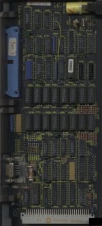

Hi,
I can now report success.
Jumper bridge J5 next to IC 7003 (type 74F14N) selects between "128k" (bottom) and "512k" (top). After replacing the 4164 chips with 41256 chips, this bridge needs to be moved to detect 512 KB of memory. After tracing a rather large amount of circuitry on the board, I also found two AMPAL16R6DC, of which one is related to DRAM address decoding.
With graphics mode disabled, chkdsk now shows 632 KB total memory:

Hi,
the success I reported was too early, and I apologize for the misinformation. The BIOS does not actually test memory at boot and since most of the software provided with the system works fine in a 128 KB configuration, memory above 256 KB is rarely accessed. I wrote a small memory test program in assembly language to verify this.
In any case, the solder bridge J5 can be switched between "128k" and "512k" and will only affect the amount of memory seen by the system. Trying to access memory beyond 256 KB will hang the system. When using 41256 DRAM chips, the solder bridge J3 (labelled MEM SEL) needs to be moved towards the connector as well.
In the attached picture, solder bridge J5 is in the bottom center/left, while J3 is in the bottom right.
Note that overwriting the beginning of physical memory will freeze the system, even when interrupts are disabled. Some BIOS interrupts, notably int 10h, will happily enable interrupts and the next timer interrupt will crash the system if the vectors have been overwritten. Touching the end of physical memory will cause the screen show interesting corruption and freeze the system as well. It appears that not only VRAM is located in this area, but also some vital information for the graphics subsystem.
