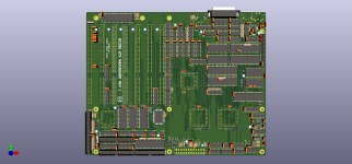

I have completed the mainboard PCB layout. Currently I am doing the whole "start to end" verification of the prototype schematics including the CPLD logic. After that is done I will create the RAM PCB layout and order the PCBs.
I am also ordering some CPLDs and the Atmel USB JTAG programmer as discussed earlier in this thread. I ordered it previously but it failed to deliver because of DHL messing up the delivery, so now I am going to order again this time from Mouser. I also bought some CPLDs and 16Mhz 286 CPUs from a Chinese Ebay seller and I will find some more sockets and stuff from Ebay. I will at least have some genuine CPLDs from Mouser and I will see if those from the Chinese seller are okay too, I saw that other buyers verified them to be fine.

At the moment I am working on all the design verifications.
I also rewrote the U87 logic equations with corrections which observe the correct polarity of signals. This since I am not using a PAL, instead U87 is a part of the System controller CPLD.
After I double checked everything in several ways, I will get to work on the RAM card design.
Then next it will be time to order the prototype PCBs for the mainboard and RAM card from JLCPCB.

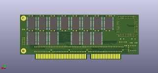

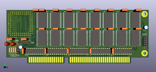

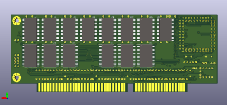

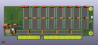

I finished the memory card design and I am almost done with the PCB layout. I condensed the layout and I will be using 4 layers for the memory card as well.
So this card contains 30 SRAM chips of 512KB each, so maximum of 15 MB which is the memory layout specification for the 286 AT. The gap at 15-16MB is reserved and intended for example for VGA cards which can map their memory into that space if it is designed that way and other memory mapped cards if needed if those operate in this reserved space.
I will finish the memory card design as soon as possible and then do a short verification before ordering the boards from JLCPCB.
In the attachments a few screenshots of the memory card to get an idea of the design what it looks like.
I know some people may not like to solder smd stuff however this design is made for extra easy soldering of the smd ICs, the pads are extra long to accommodate all variations of width and can absorb a lot of solder. Using a thin soldering tip and thin leaded soldering wire to carefully dose the amounts of solder to each pin, it is quite doable even if you never did that before. I can really recommend to try this first before resorting to DIP SRAM which is much less ideal.
For those who really don't want to solder any smd parts I may design another card later for using normal SRAM, though those are really much larger in size and hard to get original parts which are not fake. So we can discuss here later about this, I will try to accommodate those who want to use normal ICs if necessary so if you really want to build this project with DIP SRAMs we can discuss here later about this how we will do it, however it will take some development time to design a possible PCB if necessary.
First thing is to build the project soon and verify everything for proper operation. I will need some time after it is operational to test out different software and adapter cards and scope out the ISA slots to see if anything needs further cleaning up because of crosstalk and reflections in the lines. I already provided capacitor footprints to clean up the typical lines which I found before on the XT to be noisy and sensitive, especially positive polarity input signals of the system. I expect this system to be much less noisy thanks to the improved ground planes because of using a 4 layer design. I will opt for the normal thickness of copper on the inner layers just to get a really solid and strong PCB of decent quality.

I have completed the memory card design and generated gerber files for the card PCBs.
This weekend I will order the PCBs from JLCPCB for the mainboard and memory card designs.
In the mean time I received a package from China in good order with 5 CPLDs and two 16Mhz 80286 plastic Siemens chips.
I checked the CPLDs with a multimeter and they appear to be genuine.
So now I only need to find the PLCC sockets for 84 and 68 pins and I should be able to solder and test the prototype when the boards arrive from China. Other stuff like transceivers etc I can desolder from other 286 boards.
After I have the prototype fully running, I may also look into how to modify the actual 5170 mainboard to operate with my memory card design. If this is not too difficult and involved, I may test this out. I mean, to have a 5170 with lots of SRAM is also a cool idea if the modifications would be doable.
I seem to remember there was some recompiled version of Doom which should work on a 286. Of course, it will need a lot of RAM at least to be able to even start the software.
I also want to publish all the designs on GitHub soon so everyone can see my work.
After this project is finished I will be looking into a 486 design, I am not sure if it will be 16 or 32 bit.
I need to study the Intel 486 and Vesa local bus specifications and search for chipset documentation to see if a design could be realized with CPLD or FPGA logic. If it only can be done with chipsets I don't think I would be interested in doing that.
When I look at 486 mainboards it seems like possibly the vesa local bus is tightly connected to the CPU which would make sense. Maybe in those days the chipset was mostly handling the traditional logic functions such as DMA, IRQ, decoding, byte conversion and memory interfacing etc. But of course it may be my optimistic wishful thinking.
A few screenshots of the finished Memory card design are attached to this post.

I have done a PDF print of all the mainboard PCB layers if anyone is interested to check them out in vector graphics quality pdf format, you can find them in the attachment.
According to KiCad there are 3361 pads, 1609 vias, 747 nets and 30996 track segments in this design.
And here is a PDF print of the ISA memory card design if anyone is interested in seeing my work.
It's amazing that this little card has about 1/3 the design size of the much larger mainboard PCB:
1343 pads, 309 vias, 11253 track segments and 192 nets.
