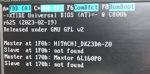

I have made a new XT-IDE AT configuration and tested with the primary and secondary IDE ports.
It appears to work properly now.
I can see a harddisk attached to the secondary, and I can see partition information in FDISK.
I tested with a NTFS drive but I will format one later on.
It seems that the MR BIOS is having some trouble with the configuration where there is only a drive attached to the secondary IDE port.
But I think it's fine when having a drive on both IDE ports.
So that's just a side note. I will do more testing later and test a CDROM drive etc.
But first I continue with sorting out the other main issues.
