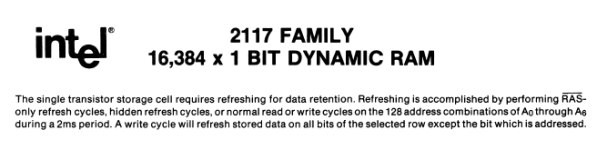

I read the experiment findings in the link you provided, that is very interesting information, I will remember this in my work later, it could prove useful.
In fact, as you pointed out, the symptoms I observed with the original IBM ROMs indeed gave similar findings as is described in this page when refreshing is manually turned off. Indeed after a variable amount of several seconds, the screen would also be blanked with a parity check error displayed.
Sometimes the period would last around 10-15 seconds, only just enough time to enter a 10 print "something"; 20 goto 10 program, run it and then the screen would blank and a parity check would appear at the top.
I should switch back to the IBM ROMs and probe the refresh logic from start to end to see if I can see something happen which corresponds with what happens on the screen. If I can't observe any refresh pulses or see the reset pulses being interrupted or erratic at any moment, it would be obvious to conclude that it's the refresh itself and not the parity checking mechanism. Thanks for pointing this out to me.
At the same time, I am still wondering, whatever the cause of the parity failures was before when only using the IBM BIOS, I did observe when using the generic MR BIOS that there was no problem using the mainboard for an extended period of time and no parity errors were happening at all during use of MS-DOS. Only when using a memory test in Checkit I was able to find some random parity errors in the test process reported by Checkit, and still no CPU stop event happened, the mainboard never halted the system at all. I could test the RAM for hours without any problems except to find occasional reporting of parity fails during the extended test sequences. The parity failures always would happen in a different memory area and then would keep occurring sequentially at that moment. I was getting the impression that this was not RAM area related but rather a random time moment where it would start to throw the parity errors and then keep doing that.
So the stability using the MR BIOS must have some reason for it. Perhaps there are checks in the code to verify the timer chip and reset it if needed, or something else happening in the background without any messages. Perhaps some sort of BIOS routine is acting similar as a refresh pulse on the RAMs, who knows...
Right now I am dealing with some urgent matters so I have cleared away the test setup and IBM mainboard. I restored all the original ICs as were present when I received it. As soon as I find a moment, maybe next weekend, I can resume testing and will do some probing with the scope. Having a properly matched schematic is really a huge advantage for me in this case.
Indeed, after your remarks and reading that page you linked, I feel it's better to start checking the refresh pulses through the whole circuit with a scope using the original IBM ROMs because they show parity faults much faster than when using the MR BIOS, just to observe if there is any interruption of refresh pulses happening.

I have done some testing on the 5170 mainboard and the results are a bit strange.
The refresh function according to datasheets is being triggered through the /RAS line of the DRAMs.
The /RAS inputs of the 512K DRAM onboard on the type 3 mainboard is all controlled by the /RAS0 signal in the IBM schematic.
PROM U72 has the input REFRESH pulse on pin 18, and on its output D0 (pin6) there is the netname RRAS0.
This goes to latch U64 pin 3(IN) and pin 18(OUT) and becomes "RAM0_RAS".
RAM0_RAS drives U53 pin 3. U53 is also driven by /MEMR and /MEMW directly and delayed, this seems to be some kind of synchronization of RAS timing. On a scope it will make more sense of course.
U53 pin 6 finally generates output /RAS0 through a 30 ohms series resistor.
What I did was to connect my scope to the PCK parity detection signal, and let it wait for the signal to go high.
At the same time I sampled the /RAM0_RAS signal to monitor if there are any changes in the signal just before a parity error is thrown and the system halts. I did the tests using the original IBM BIOS which came with the mainboard. I could see the parity stop fault happen and the system halted. Each time I could see the PCK signal go high which signals a parity fault. Just before the parity fault I could not see the /RAM0_RAS stop delivering the RAS activity signal.

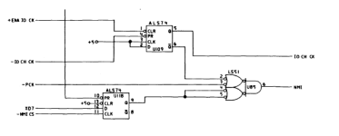

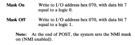

I just tried Checkit again while the problem had worsened, and indeed now it was able to trigger my scope with the PCK signal. So maybe before my cheap scope didn't catch the PCK signal.
So apparently the parity errors are coming from the PCK after all.
Just probably they were too short pulses because they were not triggering a system halt through NMI.
While trying to boot MS-DOS I was also getting parity errors from the IBM BIOS.
After a few attempts I was able to boot and start Checkit.
I already cought 2 PCK events with the single trigger function of my scope.
I will keep investigating this problem.
Maybe I should replace some of the parity detect logic, it may be marginal.
For example also U85 the LS51 whose output is involved in generating the PCK signal.
Did anyone here ever see a faulty PCK detection happen before?
I suppose that U6, U12, U85, U59 are some of the candidates for replacement.

I have done more testing but unfortunately still no luck, the parity errors still persisted so I am looking at other possible causes.
I have reflowed the CPU socket and all DRAM sockets, and tried to replace U85, a 74LS51, however both replacements I tried from other mainboards give a 107 System board error, that refers to the Hot NMI Test I saw on your website. When replacing the original one in the socket, no error 107 anymore. I will try to order some new 74LS51 replacements.
I also replaced the Time delay IC U61 just to have a try and see what happens since it looks like a DRAM critical part, and now testing with Checkit again.
I will continue to try to replace ICs which are involved in the parity detection and inserting sockets. After that if it's still not solved I will look at the ICs involved in refresh.
It seems that the parity errors are only appearing after having tested for a while now. When I start the test, everything looks fine however minutes later there are suddenly parity errors appearing. Possibly there is a problem and resulting failure when a certain component warms up.

I have not yet found the cause of the parity check errors on my 5170 mainboard.
- I have replaced all the tantalum capacitors
- I have replaced the sockets with spring types which seem to hold ICs with shorter legs better. At least, the precision types I have are not great either, they don't feel tight when inserting an IC, so the spring types I have are preferable for me at the moment. I took them from another mainboard.
- I have tested with another 74LS51 which I took from another mainboard. However I am also getting the 107 error with this IC so it appears that there is a timing difference between different brands of 74LS51 ICs.
Mitsubishi M74LS51P: not working properly as U85 on my mainboard, causes error 107 Hot NMI test
Motorola SN74LS51N: not working properly as U85 on my mainboard, causes error 107 Hot NMI test
Signetics 74LS51N(1986) does not normally cause the error 107, only perhaps three times during all my tests.
Unfortulately I don't have other ones to test with. If I find any, I will try them.
I will test more after replacing some other ICs in the parity check and refresh circuits now. To save some time I will replace them in groups.
Unfortunately I don't have other ones to test with. If I find any, I will try them.
Replacing U85 has not been successful because of timing differences between different brands of 74LS51.
I just now, pulled out two spare IBM 5170 motherboards of mine.
On one, a type 1 motherboard, U85 is a Texas Instruments SN74LS51N.
On the other, a type 3 motherboard, U85 is a Texas Instruments SN74LS51N.
I would have thought that if timing here was critical, i.e. affected by make of IC, that the engineers would have put in an ALS, not LS.
