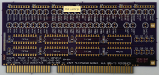

Alexandru Groza (mentioned on previous post) created also a board for debugging. I attach image below.
